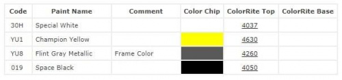

| Code | Paint Name | ColorRiteTop | Info |
| 30H | Special White | 4037 | |
| YU1 | Champion Yellow | 4630 | |
| YU8 | Flint Gray Metallic | 4260 | kolor ramy |
| 019 | Space Black | 4050 | |
dla potomnych
http://www.colorrite.com/department/suzuki-10023.cfm
